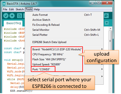

- Configure upload parameters as below (you may need to adjust configuration if you are using a different module):
    ![configuration of serial upload](a-ota-serial-upload-configuration.png)
